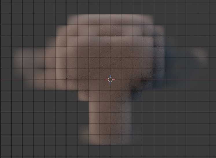

Advecting a density grid along a velocity field with some noise.

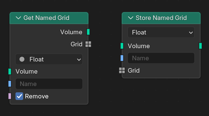

Unlike attributes on other geometry types, grids can live entirely separate from geometry sockets. That said, a geometry socket can store an arbitrary number of named grids. Common grid names are density and temperature. Typically, one has to insert the computed grid into a geometry in the end which allows giving it a name and material, but the viewer node allows viewing the grid directly without putting it into a geometry first.
Geometry sets store named grids.

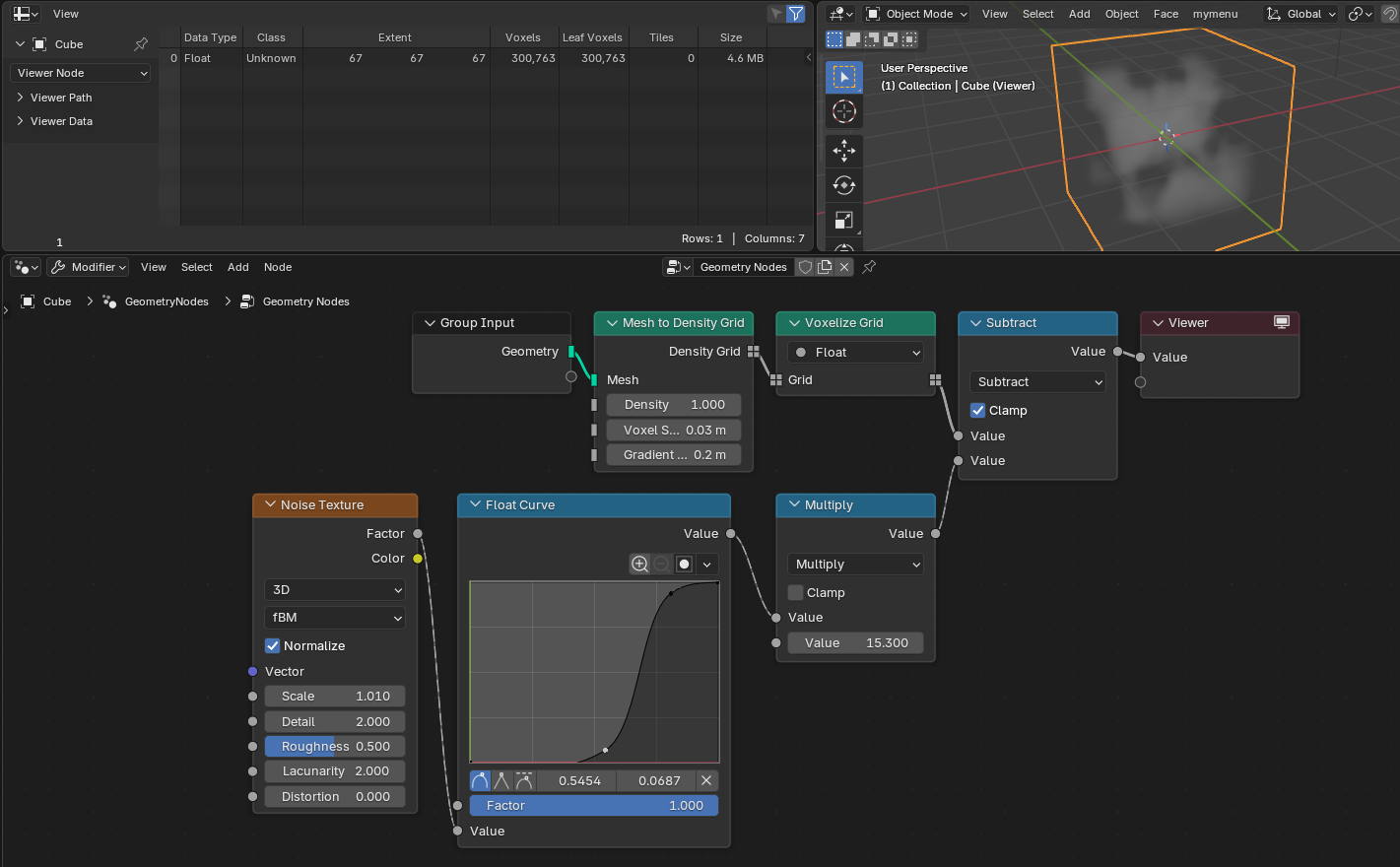

Another approach is to just use a math node. When it has at least one grid input, each field input will internally be evaluated based on the topology of the grids.
Math nodes can also evaluate fields on voxels.

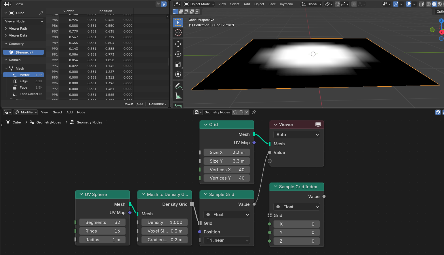

A grid can be sampled as part of normal field evaluation using the Sample Grid node. It has a position input and computes the interpolated value at that position in the grid. Alternatively, one can also use the Sample Grid Index node which provides low level access to the actual values stored in the grid.
A grid can be sampled at a position or integer coordinates.

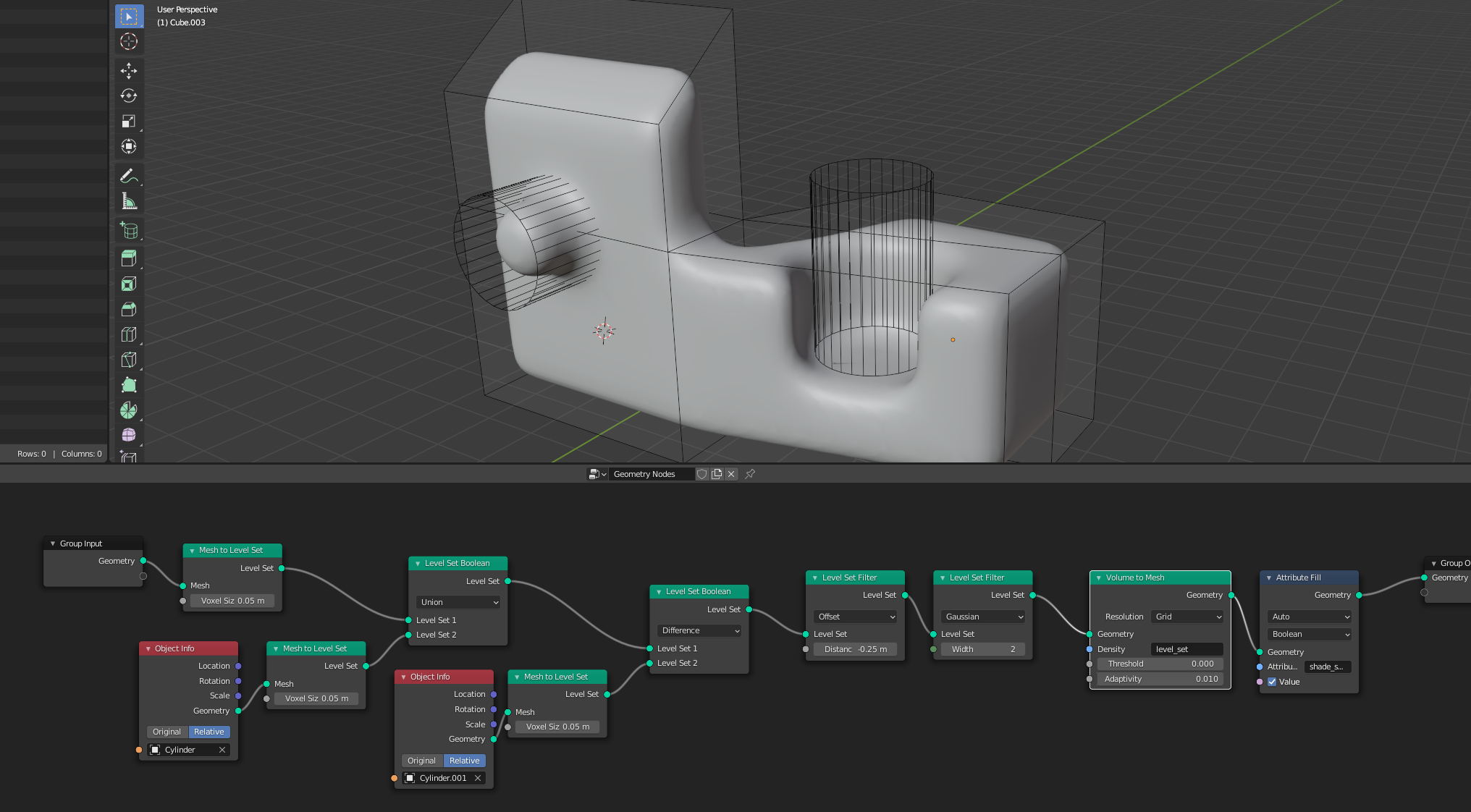

A signed distance field (SDF) grid is a float grid where the active values describe the distance to a surface. Negative values are on the inside and positive on the outside, and the surface is where the values are zero.
While this is generally a fairly inefficent way to store detailed shapes compared to a mesh, it has the great benefit of making it very easy to perform certain operations that are hard on meshes. Most notably, boolean operations with smooth transitions become simple.
SDF grids allow for efficient boolean operations.

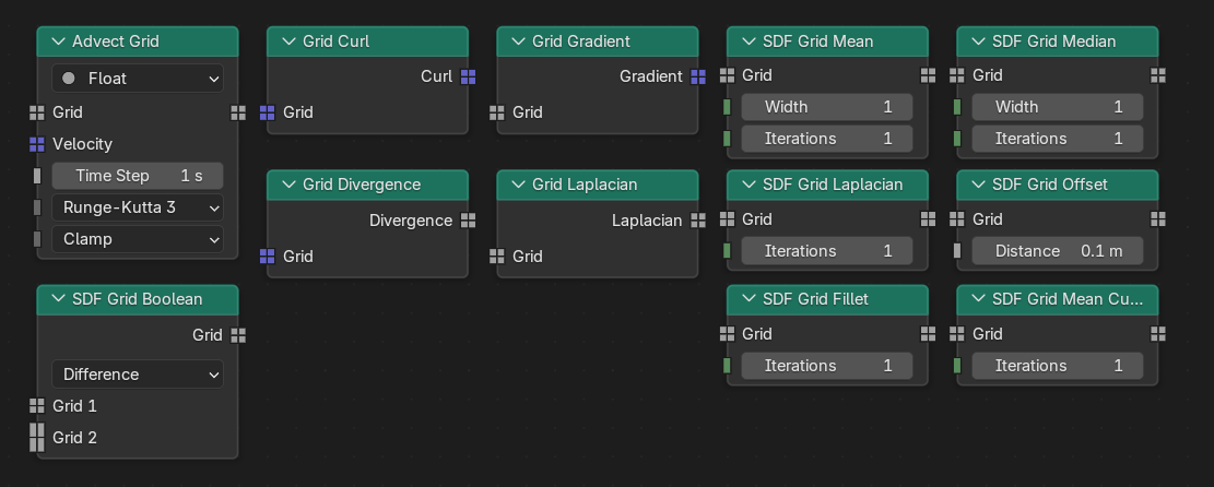

In 5.0, there are already nodes for advection, boolean operations, vector calculus operations like curl and gradient, and various SDF filters. There are still more that are not exposed yet due to time constraints, but more will come in future releases.
Many new Geometry Nodes are low level wrappers around OpenVDB functionality.
