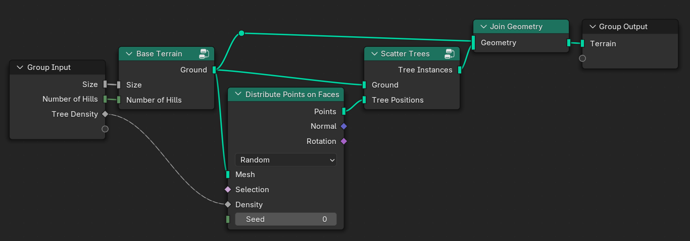

Imagine you have a node group generating a terrain by first generating a base mesh, then scattering some tree positions and then instancing the trees on those positions.
Node group mockup for generating a terrain.
Terrain generation mockup.
While this node group allows customizing the tree density, it gives the user very limited control over how trees are distributed. Giving the user more control is difficult because the point distribution happens somewhere in the middle of the node group. So it can’t just be done before or after the terrain generation.

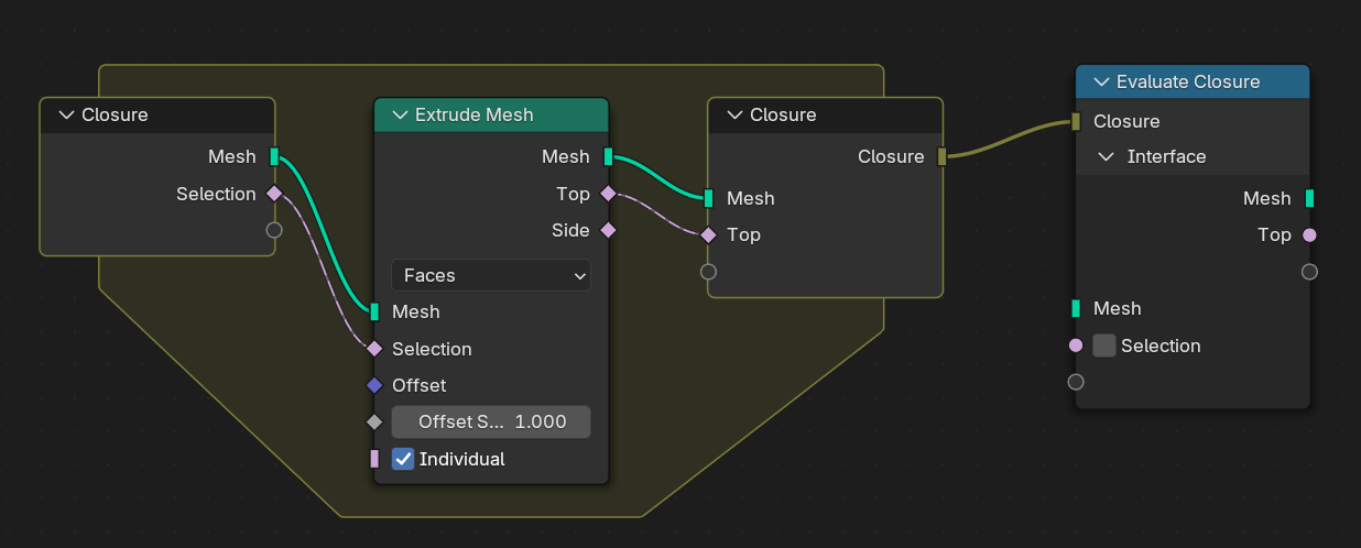

Closures solve this by allowing custom functionality to be passed into node groups. This is done by adding the new Evaluate Closure node in place of the distribute node. Then the closure has to be exposed as group input.
Terrain generation mockup with Evaluate Closure node.
When using the node group, one can now specify a custom distribution function using the new Closure Zone. What’s inside the zone is basically injected into the node group when it is evaluated. Note that the names of inputs and outputs of the closure zone have to match the names used in the Evaluate Closure node. More on that in the next section.
Closure zone.
Closure zone.

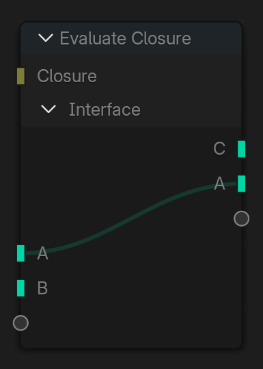

When an Evaluate Closure node is muted or no closure is connected to it, it automatically passes through values for inputs and outputs with the same name. This is very useful when the closure just is optional for the user.
Muted Evaluate Closure node.

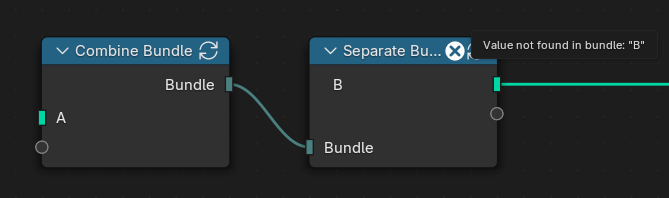

As hinted at before, both closures and bundles use names to identify their inputs and outputs. If the names don’t match, there is an error. Generally, it is not possible to automatically rename the sockets because the corresponding nodes may be in entirely separate node groups.
Missing item warning.

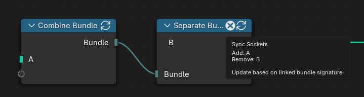

However, in practice Blender can usually infer what the correct sockets should be by following links. If it is detected that two bundle or closure nodes are connected but have different signatures, a new icon to sync a node shows up. When clicking on it, the node will automatically be updated to match what is connected.
Sync button to update sockets.
The syncing happens automatically when linking such a node for the first time. If the node already has some sockets, those are never updated automatically as it is assumed that they are intentional and updating them might lose information.
