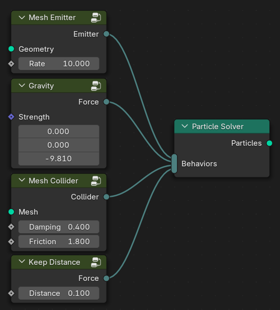

We are working towards various core features (bundles, closures, lists) that together will allow building declarative systems. The image below shows how individual behaviors could be encapsulated by node groups. All behaviors have the same type which allows easily combining them to form higher level behaviors. Also note that the order in which they are passed to the particle solver is largely irrelevant.
Node editor with four behavior nodes on the left which all feed into a multi-input in a Particle Solver node. The behavior nodes are Mesh Emitter, Gravity, Mesh Collider and Keep Distance.
This approach to building particle solvers allows someone to focus on building the actual solver that exposes a specific interface while anyone else can just build and combine behaviors for that solver without worrying too much about how it works internally.

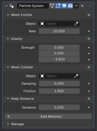

Since all behavior node groups have a very similar structure (various inputs, one behavior output), we can also build a higher level UI for managing them. For example, if the Particle Solver node group is used as modifier, the UI could look like in the following mockup. Note that each panel corresponds to one behavior and that an arbitrary number of behaviors can be added. The individual behaviors would be node group assets coming from an asset library.
Modifier having a panel for each of the previously mentioned behaviors.
Of course one always has more flexibility in the node editor, but this kind of UI should be capable of solving the most common needs without requiring the node editor at all.

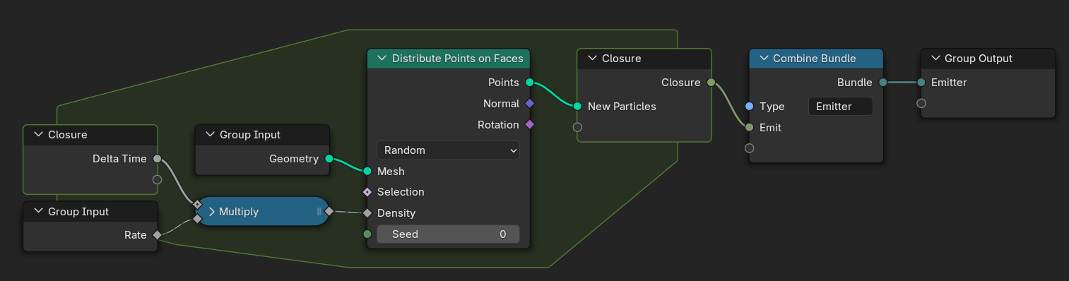

Each individual behavior will generally be encapsulated as a bundle. The exact structure of that bundle is determined by the solver that uses the behavior. For example, a very basic mesh particle emitter could look like in the image below. Note that the Type in the bundle will be used by the solver to figure out what kind of behavior this is. The solver will call the Emit callback to actually create the new particles. The inputs and outputs of the callback are also determined by the particle solver.
Closures are a fundamental feature to make this whole system work, while at the same time being a fairly niche feature that most people will not have to know about. Most people will just use systems that heavily rely on closures under the hood to be able to provide a good high level user interface.
